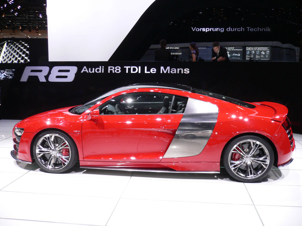

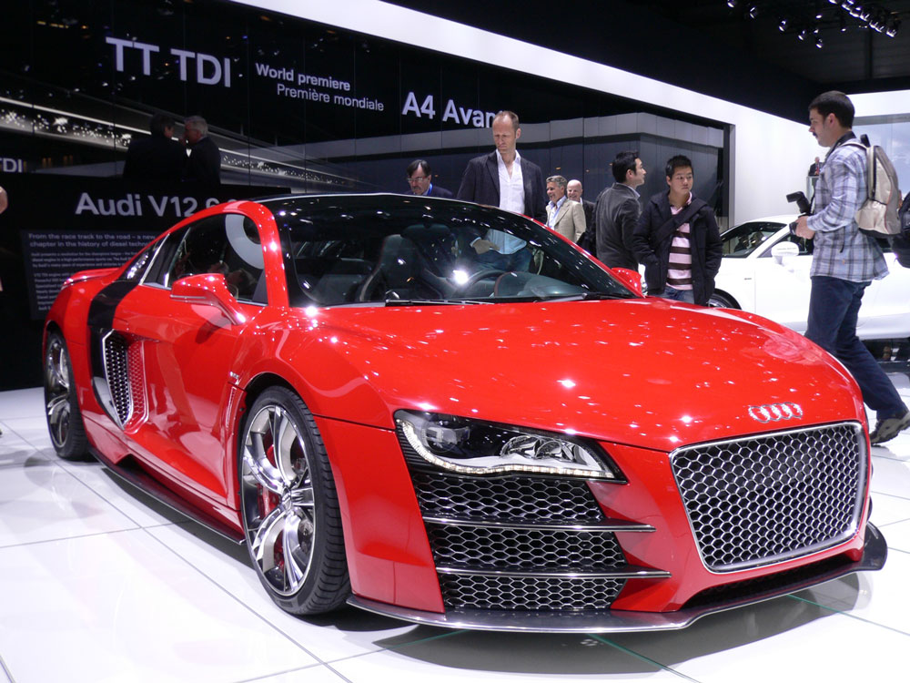

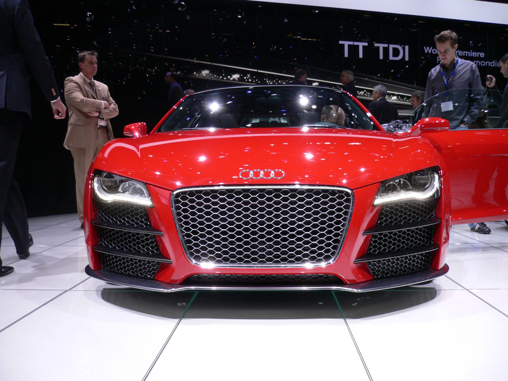

    The rumours I heard during the show from a trusted source:
    - Only very little chance for a production W12
    - R8 V10 will be showed in Paris, available Q2/2009 with massive upprice
    - R8 Spyder will be introduced together with the V10 or little later
    - There will be a baby R8, called R4 in 2010/11
    Some more pics of the beauty...

    This car looks good really good, but i'm still not going to order it .
    turbo lagg shocker that sounds like a tractor!!!! if jeremy clarkson says anything like that... expect the R8TDI to flopp
    diesel supercar is a waste of time ...nearly as much as a r4 ? why ???? the first thing everyones says when they see my car is, IT'S VERY SMALL !!!
    An r4 would be far too small or have a bloody V6 !!!!! NO GOOD AFTER I JUST SPENT 90K on a proper car.
    As for the V10 being overly expensive ??? if that's the case i'll buy a lambo or a beny for the same beans .
    And it would need to be a great deal quicker than a 911turbo but i some how i don't see that happening once VW is bought out.

    whats the colour of that side blade? I really like!
    Do you guys think I would be able to get that on my r8 scheduled for q4 delivery??
