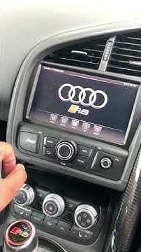

Right, final demo for now, in car, fully working, ignore the screen taps on Waze that didn’t work, I hadn’t installed the app yet. It’s being tested by someone right now but soon I will make it available for others to test and use

4 quick questions, please (and apologies if already covered previously and I missed it):
1. Does the physical 'Nav' button take you to your app of choice (e.g. Waze)?
2. Did you already have an OEM reversing camera (and wiring) in place, that you reused to some extent, or did you fit everything completely new from scratch?
3. Do all your steering wheel controls work OK (volume, next track, even the voice control button to maybe hand-off to Siri/Google)?
4. Does your fellow tester have an Android or Apple phone (i.e. will they be able to test how your adaptations work with wired/wireless Android Auto, if relevant)?
Many thanks!
122 Posts
Many thanks!
1. The physical Nav button can be and always has been able to be configured via the system settings in the head unit, my front end doesn't change that. The nav button on my front screen is hardcoded by me - it's currently set to Waze. I previously said that I made this app primarily for my own use but making it available for people to have a nicer option if they want it. So I'm not going to spend much time on making the app customisable because I don't really need to for my own uses. That being said, it's relatively easy for me to change the app that launches on that button on the screen, so I would consider changing and rebuilding a new app for different options, e.g. a Waze version or a Google Maps version etc, because there are not that many navigation software types out there so it wouldn't be a huge ask to do that.
2. Yes already had OEM - Camera adapter is included in the package to run to behind the seats and connects to the OEM camera. The new system overlays the guide lines but they don't move via steering input (I don't think)
3. Yes all works fine, I only briefly tried the voice control but I think it launches whatever voice control is part of the Android base system, not yet sure if there is a way to have it work on Carplay/Android Auto, but that's outside of the realms of what I can control either way
4. No idea what type of phone they use but to stress again, my app is purely a front end, it changes nothing with how the system works, if it worked before, it will work now, it's just a launcher for apps that looks more suited to the car, that's all.
94 Posts
Thank you
122 Posts
Do the parking sensors function?
Thank you for your efforts.
Yes as normal, you can just about see the parking sensor graphic when I put it into reverse, and hear the beeping of course. As I say, nothing about the way the android unit works is affected by my app, so if it's part of what the android unit can offer as standard, then it's still the same with my app
