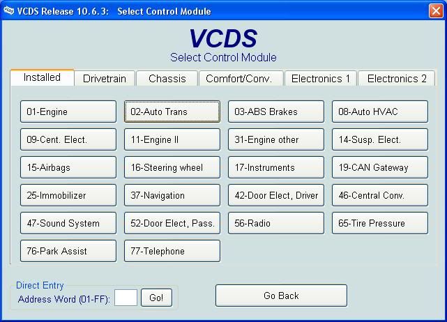

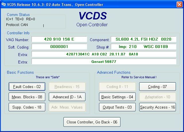

1. In VCDS select 02-Auto Trans

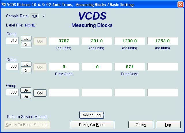

2. Select Meas Blocks - 08
3. In the group box top left enter 010 then click on Go!
4. In the next group box down enter 030 then click on Go!
You will see something like this:
In the first box along from group 010, you see I have the number 3787. This number is explained further below in a screenshot from VAS-PC.
In the first box along from group 030, you see I have 0. This means launch control has been used 0 times on my vehicle.
In the third box along from group 030, you see I have 674. This is the number of shifts x 100 performed by the gearbox in my vehicle.
Below is a screenshot which explains the transmission wear index number.
This screenshot is from VAS-PC showing the readings.
Many thanks to postdady who originally posted the screenshots from VAS-PC which show the readings which led me to investigate obtaining the same information from VCDS.

In the screenshot from VAS-PC we see 010/1 quoted which I interpret as group 010 box 1 in VCDS
In the screenshot from VAS-PC we see 030/1 and 030/3 quoted which I interpret as group 030 box 1 & 3 in VCDS. The numbers quoted in VAS-PC tally with the numbers returned in VCDS ergo I am right :)

Not sure if you are being sarcastic but the reading shows that the clutch in my R8 has plenty of use left in it. Remember, the higher the number the more worn it is. Anything close or over 8000 indicates replacement required. At 3787 I have plenty of use left out of it yet. 7738 in VAS-PC is the reading of postdady's R8. I have used those screenshots to illustrate the same information being obtained in VAS-PC only.

Measurements block 010:
2799 // 582 // 1483 // 1572
Measurements block 030:
24 // 0 // 2451
The Clutch seems to be fine as it is under 3000.

Typical values are between 3000 and 8000 therefore anything over 8000 is considered bad and equally I would imagine anything under 3000 is not ideal.
