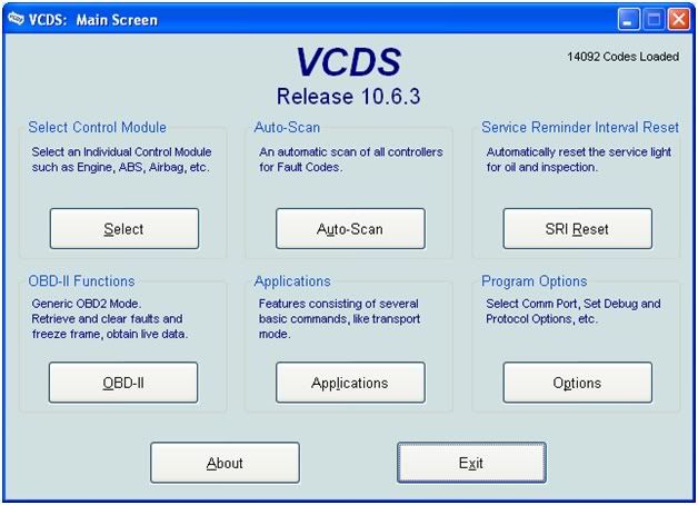

1. You will be presented with the following main screen of VCDS

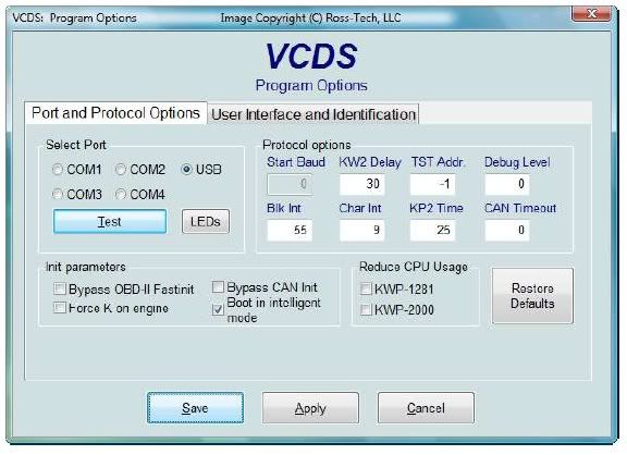

2. Click the Options button bottom right
3. You will be presented with this screen, click TEST, OK then SAVE

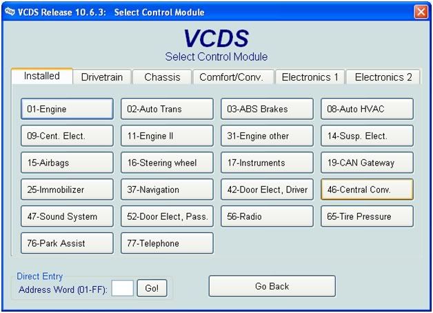

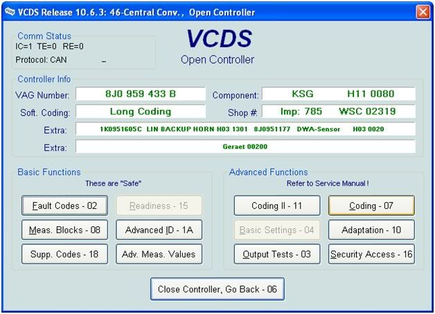

4.. Click on SELECT below Select Control Module
5.. You will be presented with this screen, click on 46-Central Conv.

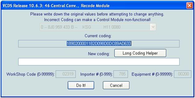

6.. Click on Coding - 07
7. Highlight and copy the current coding (the big long number) and paste it into a text file or Word file etc just somewhere safe incase you need it later.
8. Paste the number into the bottom box New Coding
9. Change the 8th number along to a 2.
In my case this went from being
1890200201182D098505489AD633
to
1890200001182D098505489AD633
10. Notice how I have only changed the 8th number along to a 0 to deactivate the rear spoiler.

6. You will be presented with the following main screen of VCDS
7. Click the Options button bottom right
8. You will be presented with this screen, click TEST, OK then SAVE
9. Click on SELECT below Select Control Module
10. You will be presented with this screen, click on 46-Central Conv.
11. Click on Coding - 07
12. Highlight and copy the current coding (the big long number) and paste it into a text file or Word file etc just somewhere safe incase you need it later.

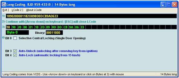

13. Click on Long Coding Helper
14. You will be presented with this screen. At point 1) you can see the entire coding then at 3) the coding is split into blocks with an explanation below which allows you to change the coding.

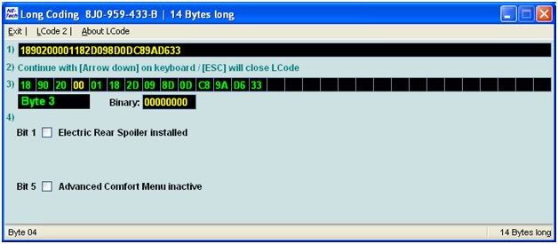

15. The fourth pair of numbers is called Byte 3 as detailed in the picture below. You can see at the bottom there is a checkbox next to Bit 1 which refers to Electric Rear Spoiler Installed
16. Uncheck the box and click EXIT top-left
17. The new coding will be entered in the bottom box automatically
18. Click on Do It!
19. VCDS will confirm if the coding has been applied correctly.
20. Close the VCDS Application and disconnect the cable from the OBD-II port of the vehicle.
21. All finished, the button in the centre console for the rear spoiler should no longer work and the rear spoiler will no longer rise at the pre-determined speed automatically because it has been completely disabled.

Gents, sorry to bump an old thread... But I'm having trouble getting the 46 controller to read. Every time I click on it, it says No response from Controller.
Authentic vcds cable, latest software, tried both win7 and 10.
Any ideas?
Thanks.
Administrator
6,285 Posts
Try 09 Central Electric, I know on some cars you have to go through a different module
838 Posts
Have you got this option.?
1) Module 09
2) Long Coding (07)
3) Byte 10 – change Hex from 4C to 44 (or from Binary 01001100 to 01000100)
Or just untick «Rear Spoiler Installed»
4) Do it !
Make sure you take a screen shot before you change anything just incase you need to put back to stock.
Good Luck
Administrator
6,285 Posts
You're right! Found "rear spoiler installed" in the 09 controller.
That's all, right? I unchecked it and "did it". Ha!
Great! Much easier to just check or uncheck boxes since I don't get the hex's, bytes and binary stuff all
