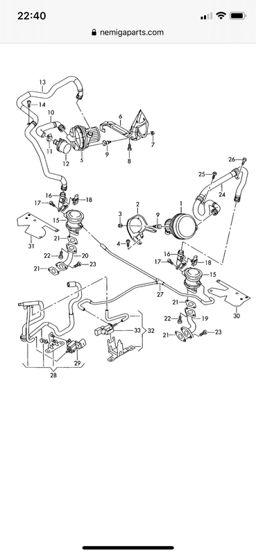

Hi
The AKF tank is located on the right under the engine control unit.
The secondary air valve is located under the intake manifold.
Tom
428 Posts
Hi
Yes, that's right and I've been dealing with it for years and so has ETKA.
The arrangement of the parts in the picture corresponds to the arrangement in the vehicle and for me this is easily recognizable, not for a newcomer.
Tom
