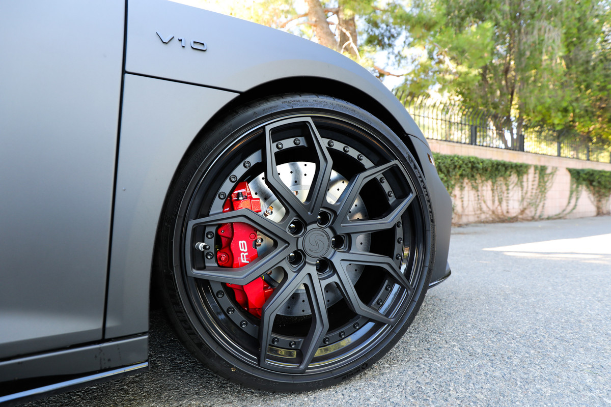

Look at this ring of rust that forms around the center, very difficult to keep clean, anyone have any tips? Maybe should have just got ceramics after all.

Girodiscs are coated well. Time and heat causes small exposed areas of rust on rotors that are not "cleaned" by the pads. Floating rotors will have this small ring of surface rust you are noting. The OEM R8 coated rotors rust the same except the pad interfaces the entire exposed face since it is not floating. OEM is rigidly mounted to the "hat". You see the outer and inner rotor rust below.

You have this rust "slinging" all over the inside of your wheel? We do not see this behavior after over 10,000 miles including a number of runs at the track with track pads.
#14 ·
yea hard to believe but you can take a look here with your own eyes and see for yourself. Not sure how the rust slings off the rotor, maybe when it’s being scraped by the brake pad there’s enough moisture that it creates some kind of slurry that ends up all over the wheel in this sort of pattern. Either way, never really had this problem before. I’ve driven over 88k miles in this R8 and it lives its life outside never really garaged.

Yes, this I have not remotely seen, but ours is mostly garaged. Yes, I suspect this is surface rust on the face of the rotor being scraped off in the next few stops although likely in the rain/still wet based on the picture. And/or rust from the rotors edges and vanes perhaps due to being out in the environment so much. The small band of rust to the inside that you noted above does not seem like it would be the cause of this mess.

That looks like the rotors were Rusty from a car wash or sitting, and then started driving off in the wet.

I was going to say zinc washed rotor option on my stoptech's on another car prevented the rust on non-swept areas of the rotor. Also, I think that rust being slung isn't from the pad surface, its the rusted areas in between the rotors swept surfaces, where the veins are. If the car sits out overnight, condensation and rust is forming in that area and getting slung off when you drive it next in the AM.
